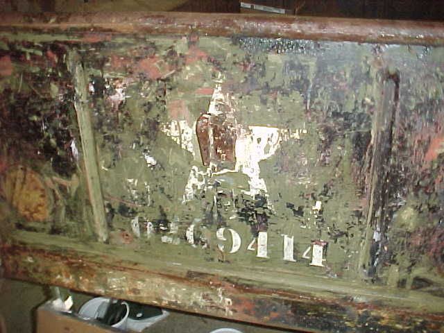

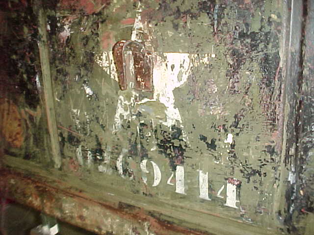

Postby Ben Hovis » Fri Oct 05, 2007 7:02 pm
Well, how exciting! I found the USA # on the rear of my bantam. Guess I will have to ask Chuck to check it out again. Below the USA number there are other numbers but can only read a B. There is tons of paint and in quite weathered/peeling condition.
Chuck will this help locate the actual serial number? Appreciate your help.

Postby Ben Hovis » Fri Oct 05, 2007 7:06 pm
Forgot to post the USA # 0269414. Earlier estimate was 0269684 really close.

Postby Chuck Lutz » Sat Oct 06, 2007 2:08 pm
When Ben first contacted me he had only the ACM number and enough info to determine his trailer was a Bantam. Now that he has taken the time to carefully sand and reveal the actual USA number on the rear panel of the trailer I can narrow the estimate I gave him.
His actual USA number was only 270 off of the one I estimate for him which is remarkable since in that range of Bantams on my list, both Bantam and Willys shared the same sequence of ACM numbers which makes it hard to estimate the missing data. In addition, I just didn't have enough guys who had sent me actual Data Plate info and ACM info or even the USA number info to get an understanding of where to place those belonging to guys with only the ACM number.
Since Ben has the ACM and the USA numbers from his trailer, that info helps me to tighten up my estimates of other trailer data and it confirms that I am correct in the order in which the contracts were issued and the numbers in each of them.
Thanks to Ben's perserverance in finding his USA number, I have been able to tighten up the estimates of data for a half dozen trailers in the same range of ACM numbers that are missing the data plate. Harold Lang contacted me only a couple days ago with an ACM number and I gave him my best estimates with a caution to contact me later to see if any improvements in my estimates could be provided. Today I sent him some updated info based on Ben's information.
That's why I thank Ben and all of you guys who have sent me the Data Plate and ACM and often even the USA numbers you have found, since that info makes my data base able to estimate info for those who are missing the data plate or who need only a USA number.
If you guys need any info or if you can help me by sending me your Data Plate info and the ACM number.....and the info in the "How To ID" post, that would be appreciated by me and I know by those who are now able to get close or exact information for their trailer.

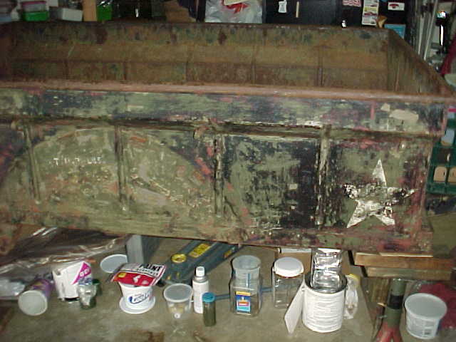

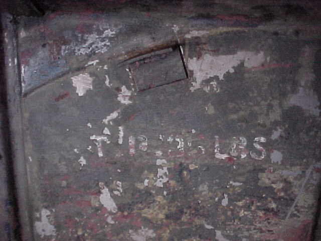

While cleaning up the passenger side of my Bantam I found a couple more stencils.
One is under the fender mount that says Tire 35 PSI and up front is another Star. Did motor pool put the PSI message on the tub? You would not see it if the fender and tire were mounted only if the tire was off.
Hope to find some items as I go around the body.
Ben

Postby jeepjop » Mon Oct 08, 2007 10:18 pm
Ben,
I'm going to be doing the same to one of my trailers soon can you explain the process you used to get those great results? it dosn't look like you did any sanding am I right? I still need to get all my info to Chuck on both my trailers.
Best regards,
Joshua
jeepjop
Posts: 325
Joined: Wed Feb 21, 2007 2:47 pm
Location: idaho
Postby Ben Hovis » Tue Oct 09, 2007 1:39 pm
Joshua,
You are right I started sanding and there was just too many coatings of paint, so went to a paint and varnish remover. I had several Gee folks and body shops tell me to use "Air Craft (Kleen Strip) Remover Finish and Primer".
You can purchase from an auto body supply house. The cost is $35.00 a gallon. You do get pretty good coverage. In California we are not able to get strong products anymore (restricted).
You apply with a paint brush with a some what thick coat. Do not brush back and forth as it looses some of it's punch. Allow it to soak on the surface you are removing for a min. of 15 minutes (for the most part I let it set for 1/2 hour). The paint will blister. Then I used a putty knife with a 3 inch wide blade to remove the blistered paint. Then I took an old wet cotton T Shirt and rinsed (wiped down the service where paint was removed). Water netrualized the Air Craft Paint Remover.
When the white stencils appear I was careful in the scraping process. Some times using a small steel fiber brush. I did find some of the original blue stenciling but was not near as easy to read as the white stencils.
My guess is when the first coat (was applied to my trailer) of primer and OD with the blue stencils and was re-painted later with primer/OD and white stencils then over the years several other coats of paint (different colors) was applied.
You may be able to get a stronger paint and varnish remover in your state???

Postby Ben Hovis » Tue Oct 09, 2007 11:14 pm
Luca,
Thanks for sending the picture. Is that a 35 PSI stencil under the fender?
Do most WW 2 trailers have that stencil? I had not noticed it before.
Thanks, Ben

Postby W. Winget » Wed Oct 10, 2007 7:54 am
My 42 GPW had stenciling of "Tire Press 35 Lbs" or such under the front fenders when I sanded them down, so I don't doubt it's a WWII or unit derived Standard Operating Proceedure (SOP) to mark the pressure under the fenders at some units, including trailers.

Postby lucakiki » Wed Oct 10, 2007 10:02 am
Ben Hovis wrote:Luca,
Thanks, Ben
Mine just reads TP 35: I have stenciled it! I had found remnants of such a stencil. I would say that it is far from common, but as you found out yourself, it was done at times. Enough to justify it, if you feel like doing it.
